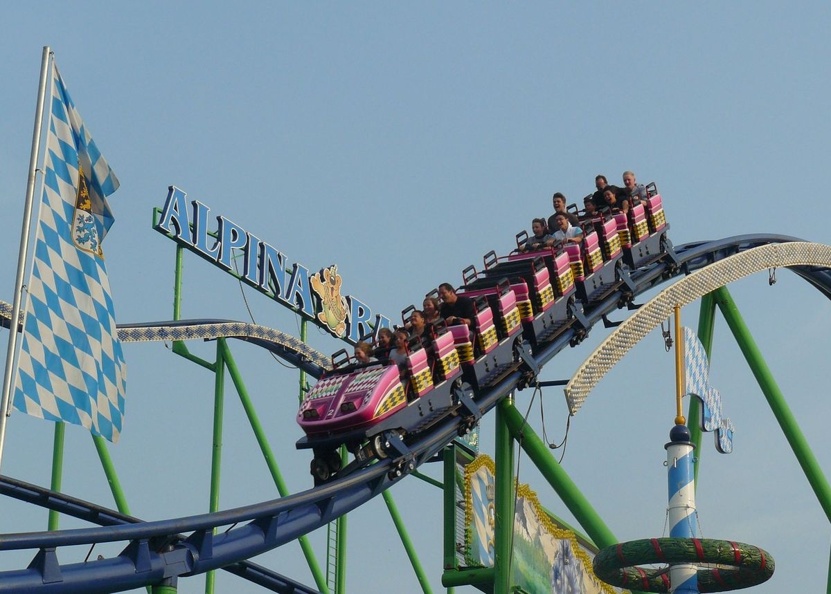

Train’s always need a zero car of sorts, because they’re trailered. Either that, or the first and second (or last and 2nd to last) carriage needs to be rigid. The easiest way to see this is by looking at a B&M floorless or Invert, the first row acts as the zero car - it’s completely attached to the second row, with only the rotation being separate.
Now, looking at the design of the Vekoma flyer, the rotating centre of the seats are placed centrally in the bogies. I would assume this means that it’s much more difficult to go zero carless (usually seating is more central to the train carriage, the Vekoma design has the seats on one side). And the distance between bogies should be uniform through the whole train, hence why there’s such a gap.
@roomraider - yeah that’s right! If you think of it like a Lorry/Truck and it’s trailer. The trailer can’t stay upright on it’s own without support, the same goes for rollercoaster trains. It gives the train stability, keeps the seats upright etc.
Now usually a coaster car has 2 rows, which makes it easier to have the above setup (Intamin trains, Mack Train etc). But when a coaster is trailered, such as a B&M train, it needs a zero car (the zero car, and the first row make the same set up as Alpin Bahn’s first car).
